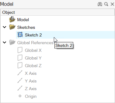

Select one or more faces, sketches, lines, or edges. To deselect, hold down Ctrl while clicking.Tip: Select a sketch in the Model Browser to quickly select all of its entities. If you add sketch entities after you revolve, the new entities will also be revolved.
