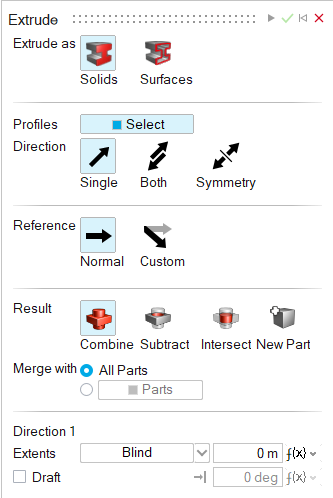

The guide panel appears.
Choose the entity type that you'd like to create:
- Solids: Extrude as solids.
- Surfaces: Extrude as 3D surfaces with optional end caps.

Choose a Direction:
- Single (default): Extrude in one direction.
- Both: Extrude in both directions.
- Symmetry: Extrude symmetrically in both directions.
Choose a Reference orientation:
- Normal (default): Make the extruded shape normal to the curve or 2D surface.
- Custom: Extrude in a custom direction by
selecting one of the following options.
- Select: Select a linear edge or an axis to which you want to align the extruded shape.
- Free: Freely orient the extruded shape by dragging the curved arrow or entering an angle in the microdialog.
Choose a Result type:
- Merge (only available for Solids): Merge the extruded shape with the existing parts.
- Subtract (only available for Solids): Carve out the extruded shape from the existing parts.
- Intersect (only available for Solids): Retain only the intersecting portions of the extruded shape and the existing parts.
- New Part: Create a new part from the extruded shape.
If you selected Solids, choose a
Merge method:
- All Parts (default): Merge the extruded shape with all parts that touch the extruded shape.
- Parts: Select the radio button to merge the extruded shape with selected parts. Then select the parts that you’d like to merge the extruded shape with.

Adjust the extruded shape along Direction 1 or
Direction 2:
To Do this Notes Adjust the extrusion length Do one of the following: - In the microdialog, enter the
Distance
. - In the guide panel, for Extents, select Blind, and enter the Distance.
