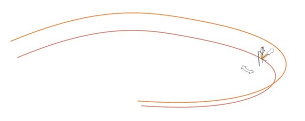

Click one or more curves.
The source curves are displayed in red, while the offset curves are displayed in orange.
Define the offset distance:
- Drag the offset arrow.

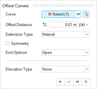

- In the microdialog or guide panel, enter an Offset Distance.
Edit the curve offsets.
To Do this Change the offset distance - Drag the offset arrow.
- Enter a value.
Invert the offset In the guide panel, next to Offset Distance, select
Reverse Direction.Create an offset curve on each side of the source curve In the guide panel, turn on Symmetry. Modify the shape In the guide panel, select one of the following End Options: - Open: Leave the offset curve open.
- Closed and Straight: Create a closed loop. The source curve is hidden when you exit the tool.
- Closed and Rounded: Create a closed loop with rounded ends. Cannot be applied to 3D curves.
Translate the offset curves Change the Elevation Type from None to one of the following: - Normal: Make the offset curves normal to the source curve. You can drag the elevation arrow or enter an Elevation Distance, which is the distance between the offset curve's plane and the source curve's plane.
- Custom: Move the offset
curves in a custom direction. You can then select
- Select Direction: Select a linear edge or axis normal to which you want to offset the curves.
- Free Direction Mode: Freely orient the offset direction by dragging the curved arrow or entering an angle in the microdialog and by dragging the elevation arrow or entering an Elevation Distance, which is the distance between the offset curve's plane and the source curve's plane.
