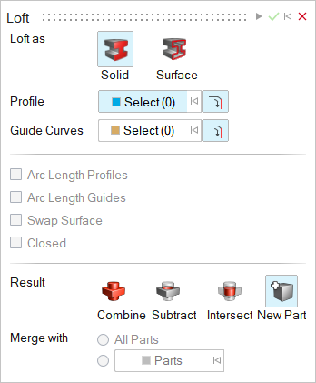

The guide panel appears.
- Select
Choose the entity type that you'd like to create:
- Solids: Loft as a solid.
- Surfaces: Loft as a surface.

Edit the loft:
To Do this Notes Reselect profiles or rails - In the guide panel, click the Select button next to Profiles or Guide Curves.
- Select the profiles or rails you want to add or remove.
Define other options In the guide panel, select from the following options: - Arc Length Profiles: Evenly space the isoparms in the direction of the profiles.
- Arc Length Guides: Evenly space the isoparms in the direction of the guide curves.
- Swap Surface: Quickly interchange the profiles and guide curves to get a preferred shape.
- Closed: Close the loft.

Choose a Result type:
- Combine (only available for Solids): Combine the loft with the existing parts.
- Merge (only available for surfaces): Merge the lofted surface with existing parts
- Subtract (only available for Solids): Carve out the loft from the existing parts.
- Intersect (only available for Solids): Retain only the intersecting portions of the loft and the existing parts.
- New Part: Create a new part from the loft.
If you selected Solids, choose a
Merge method:
- All Parts (default): Merge the loft with all parts that touch it.
- Parts: Select the radio button to merge the loft with selected parts. Then select the parts that you’d like to merge the loft with.
- Click Apply.
