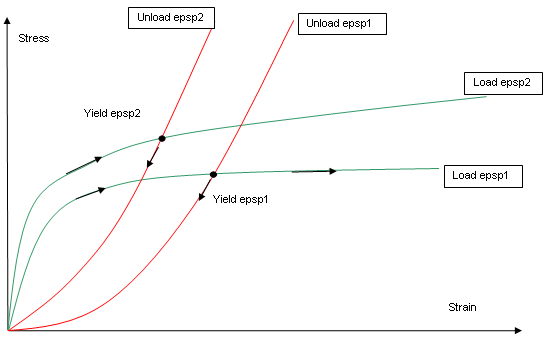

  4. If the load is removed prior to the intersection point between loading and unloading curves, the unloading follows the hyperelastic path with hysteresis (Fig. 1). This path is calculated based on the value of Young's modulus, E until it intersects with the unloading curve. Thereafter it follows the unloading curve back to its initial state (0,0).

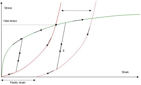

    If the load is removed after intersection point between loading and unloading curves, the unloading curve is shifted by the value of plastic strain (Fig. 2).

    Figure 1. Loading and Unloading Function Sets for Constant Strain Rates - Hyperelastic Loading/Unloading
    mat_law65_strain-stress
    Figure 2. For Plastic Case the Unloading Curve is Shifted by the Value of the Actual Plastic Strain
    mat_law65_plasticstrain
