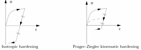

Chard Plasticity Iso-kinematic hardening factor.
= 0
Hardening is full isotropic model.
= 1
Hardening uses the kinematic Prager-Ziegler model.
= between 0 and 1
Hardening is interpolated between the two models.
Default = 0.0 (Real)

    clip0050

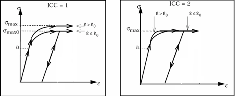

  6. ICC is a flag of the strain rate effect on material maximum stress σ max :
    law_plaszeril
    σ = σ y ( 1 + ( ε ˙ c ) 1 / p ) σ = σ y ( 1 + ( ε ˙ c ) 1 / p )
    σ max = σ max 0 ( 1 + ( ε ˙ c ) 1 / p ) σ max = σ max 0
