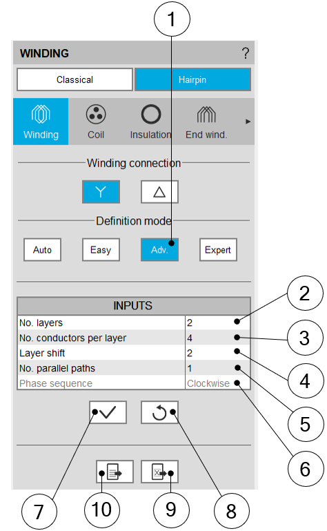

1. User input parameters
| Label | Symbol | Tooltip, note, formula |
| No. Layers | * | Number of layers (1 or 2) |
| No. conductors per layer | * | Number of conductors per layer |
| Layer shift | * | Layer shift in number of slot pitch (Only available with 2 layers) |
| No. parallel paths | P paths | Number of parallel paths (1 or 2) |
| Phase sequence | * | Phase sequence |
2. Building the winding architecture – Advanced mode – Main principles
| Building the winding architecture - Advanced mode | |
| 1 | Selection of the Advanced mode for building the winding architecture. |
| 2 | Selection of the number of layers. The number of layers are limited to 2. |
| 3 | Number of conductors per layer, it must be even and limited to 30. |
| 4 | The layer shift is defined by the number of slot pitch. It cannot exceed the number of slots per pole and per phase. (Only available with 2 layers). |
| 5 | Number of parallel paths. The possible numbers of parallel paths are automatically computed and proposed to the user, 2 is the maximum value proposed according to hairpin pattern used. When the user chooses several parallel paths. The connections on the winding scheme are automatically updated. |
| 6 | Definition of the phase sequence i.e. the rotation direction of the
Magneto-Motive Force (M.M.F): Clockwise or Counter clockwise. The rotation direction is defined when facing the machine on the connection side. The phase sequence is set to clockwise and cannot be modified in the current version (grayed field). |
| 7 | Button to apply inputs. Pressing the enter key twice applies inputs too. |
| 8 | Button to restore default input values. Default values are those which define the winding architecture by using the automatic mode. |
| 9 | Icon to export winding data into *.txt or *.xlsx files. |
| 10 | Icon to export hairpin winding connection table into a *.xlsx
file. This file can be shared and reloaded in another FluxMotor session. |
