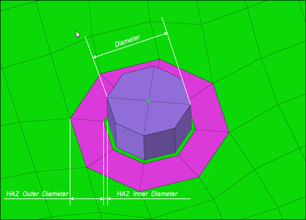

| HAZ Inner Diameter |
| HAZ Outer Diameter |
