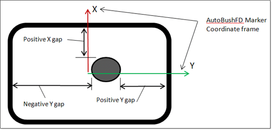

The figure below illustrates the concept of positive and negative gap for mount limits in a bushing:
1.
