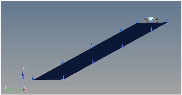

1. Straight Line Acceleration event
2. Straight Line Acceleration eventの上面図
